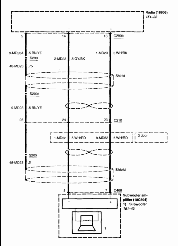

ok...so i bought my SVT back in March, and my stock sub hasnt been working since i got it. i went through tonight, and tried to hook up the old wires that the previous owner cut, and left...didnt work, so i snipped his extra wires, that he jimmy rigged into the stock wires...can anyone tell me how to fricken wire the thing?! i clearly have no idea what the heck im doing...

i don't know how the stock setup is. but which wires, from what to what? did you check all the fuses? is the amp good? is the sub good?

i honestly have NO idea what Im doing...or how to tell if any of it is good...there is no sound at all from it. it all still looks like it is connected,thats where im lost

is it a stock deck or after market. if aftermarket dont count on it with stock player YES..
your best bet is to find a wiring diagram for the system. untill then its gonna be like running full boar through a mirrior maze. :lol: :lol:

hope this helps
