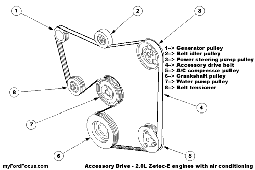

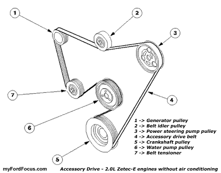

Well, ford sure got lazy and didn't put a diagram under my hood, I beive its all I need to get this car off the jack stands.
Anyone got a pic or something?
03 zetec...

check under the right front side/ the a/c shroud, if not just try it only goes on one way and the easist way to do it is take that motor mount out the way,, trust me ive dune thousands of those, i wished i lived closer id do it for ya it takes like 4 minuts.

Anyways, after I got under the car and figured it out, it only took me I shit you not 23.5 secs to put the belt on and it runs, motor mount still in place....

did mine last weekend with motor mount on, not a problem... tensioner uses like a 14mm or 15mm, pretty simple
15mm.
