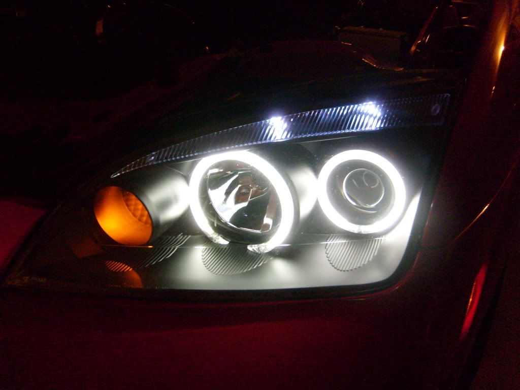

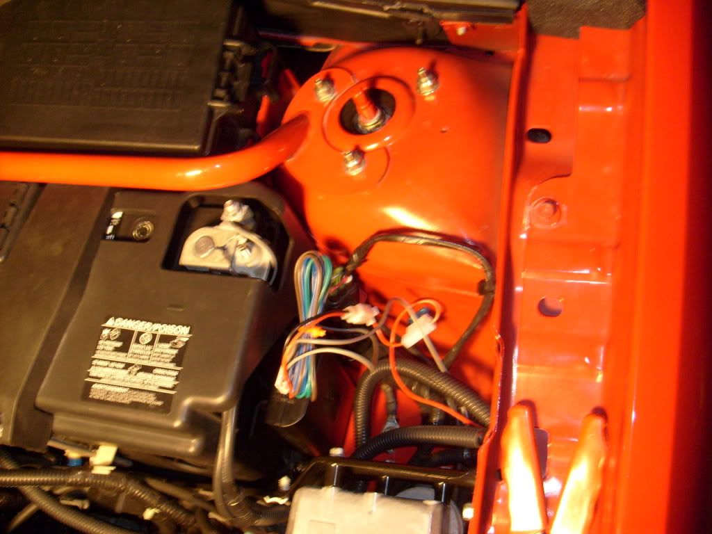

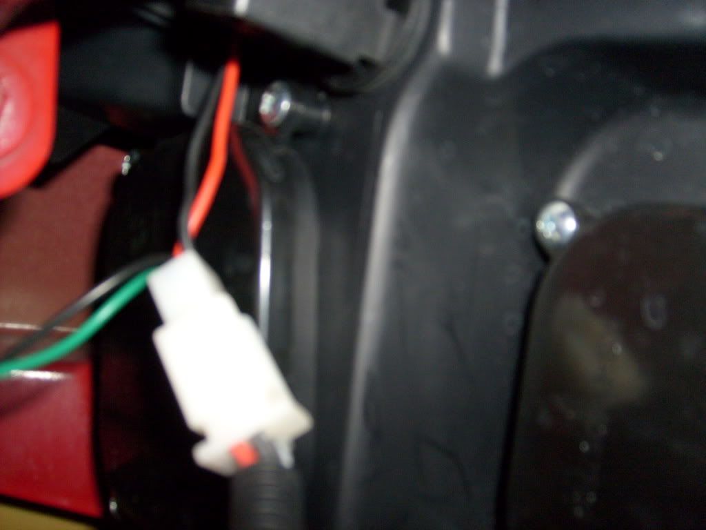

I have them on my 06 St. The halos and L.E.Ds are powered by its own set of wires. Green and black for the halos and red and black for the L.E.Ds. Then they come together into a plug going from four wires down to two: a red and black. You can hook them up any way you want to. With the the headlights, parking lights, or you can hook them up to a switch. Mine are hooked up to a wireless switch with a key fob to turn them on and off when I want. I'm not sure if they are street legal but I have been running them for a few weeks now and I have never been pulled over for them. As for brightness the low beams are not bad. The light is shot right in front of the car in a nice spread. The high beams do kind of shoot the light all over so there is no light focused in one spot. As for light bulbs they use H1 and H7 bulbs. I think H7 were the lows and H1 for the highs. If you do buy them make sure you get the ones with the ccfl halos, they are really bright and look really nice.
I took some pics to try to give you some idea of what they are like. If you get them and need help I'm more than happy to help you put them on. Hope this helps
wireless box controller
wires for L.E.Ds and halos going to plug taking the wires from four to two.

the halos aren't illegal. they are forward facing white lights, they are just like running light. the leds though. they kinda look blue, which could be illegal depending on tint. i have blue headlight that are legal. if they ain't any bluer then my headlights, then they'll be ok. if/when i get mine i'm going to hook them up to the parking lights.
